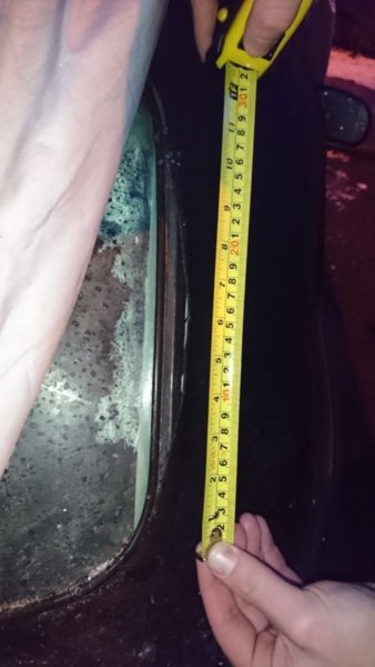

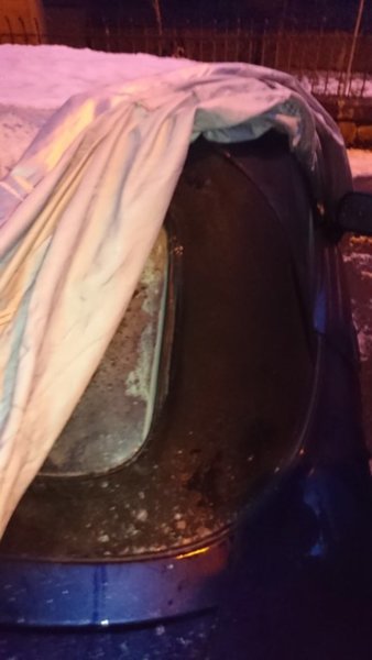

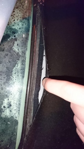

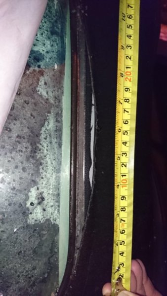

Evening
Managed to get out to take a few snaps of the offending hood just before the light was gone. I only took one side as the other is a similar story. I didn't get the full car cover off as its frozen on at the moment and i can only imagine the damage to the paint. Who knows what a clean,claybar and polish will reveal?
So after actually using a tape measure, its about 25cm not 40cm as i said above. The Hood still feels in decent condition, i can only guess its original as this car lived 60k miles of its life on the southcoast of England owned by someone who took care of the car. Probably garaged. 60k of BMWFSH too.
I hope the pictures showing the hood make everything clearer.
Thoughts on going for the Nylon-thread-sew-up as @Stevo7682 had suggested or is this the hood to far gone?

If its the same both sides and only on the straight bits of the sides i would have a go at repairing it 1st before giving up on it totally.
The top and bottom sections are actually pretty sturdy. Needs a right good clean but the threads look solid and no signs of rotting or freying. Ill need to so a little bit of the curve on the other side but im going to give the stitching a go before seeing about a completely new hood.
Trying to organise an underground/indoor parking space so i can work on the car for a day or two in decent environment as see what comes out.
