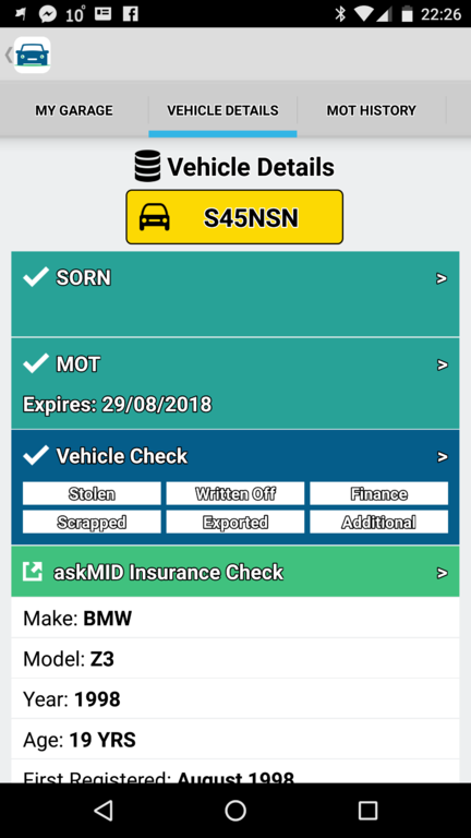

No Dino, they're simple. Provided the screws don't shear off when you loosen them. Tap them on the end and gently tighten them before undoing. You only need to remove the disc to get on the screws. I'm fairly sure the Z4 is the same as the Z3.
