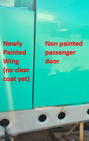

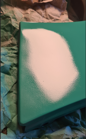

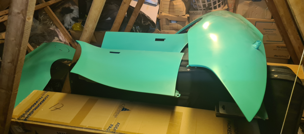

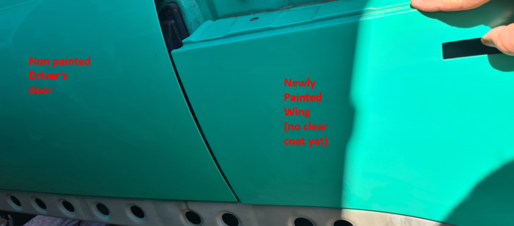

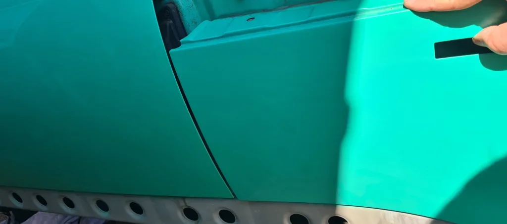

Laid down top coat over my repaired repair.... and I've finally gotten rid of the lump that was bugging me....
as before, it looks orange peely but dries dead smooth
Uncovered the poor car to let it have some sun and Vitamin D =)) =)) ..... offered up the freshly painted wings and the colour match is superb !!..
the next stage is to tidy up the passenger rear quarter, paint that fully..... then 2k Clear Coat on the lot...

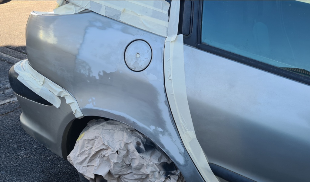

well there's be a couple of weeks delay on the Z3, and forgive me for posting pics of a non Zed, but while I had got my painting technique as good as I could get, I paused a bit so that I could paint the rear end of my Peugeot Estate...
it's sort of relevant in terms of prep and getting the preparation right is absolutely key.... getting the right grade of sandpaper, then flatten with wet and dry around 2000 grit. I then went over the whole area in Meths (as I didn't have panel cleanser). Then a nice even spraying technique from a rattle can. Leave 15 minutes between coats. I did three decent coats for the rear quarter and then blended in the door, finishing about halfway along the door. Let that dry overnight (luckily it was decent weather!).. then another light wipe over, then three even coats of rattle can clear coat... let that cure for a week before any cutting or polishing.

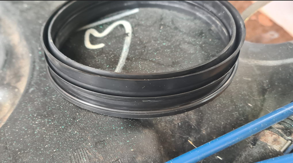

So I pulled the fuel pump and dug out my trusty 100mL Syringe.....
First...the fuel pump, absolutely spotless on the inside and not a spec on the filter
Started draining with a small dish but was taking forever.. the fuel felt a little like jelly..... that must be all the absorbed water...
Then my trusty syringe came to the rescue with a tube on the end...
ended up drawing out 13 Litres of dirty Unleaded with a 100mL syringe.... delightful.. and that's a 25L drum
Inside was nice and clean and the fuel pump seal was perfect
Being 13Kg lighter, the tank is SO much easier to move around... noticing it was REALLY grubby though..... I sprayed it in WD40 and ragged it down but I'm not sure how long that will last...
This is why you have fuel compatible rubber.... look at what siphoning the fuel did to the syringe seal.....that was all smooth beforehand...

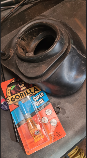

I also repaired the Filler neck gaiter as I didn't realise how pricey they are !!
all the splits repaired with Gorilla Superglue which is really good...
remove the drain carefully by prying open the clip
stitching it back together was like a jigsaw... one bit was missing so I trimmed an old bit of EPDM rubber to fill in
clean up with brake cleaner and looking much better !

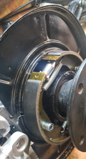

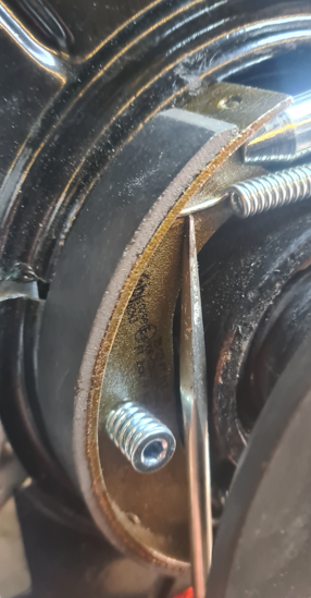

today I thought I've have an easy session putting the new rear handbrake and new shoes and fittings.....:whistle: :whistle: :whistle:
handbrake mechanism went on fine and one shoe.... fine.... bottom spring.... oookkkaaaay.... top spring !... aaaaarggh !!!... half an hour wrestling with it...
I tried levering with a screwdriver.... nope.... pulling with a bit of garden twine.... nearly !!
I could get it over the hole... but not enough leverage to clip in....so for now I've given up as my hands are hurting.....and I'm in danger of not being able to hold my glass of Gin....
STOP PRESS !.

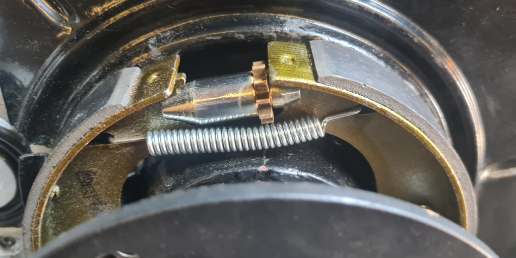

.... right... I wasn't going to let it beat me.... so tried a different screwdriver levering technique and..... SUCCESS
Took an "after the fact" photo, to remind me in the future !!.... use the hub for leverage and just enough of the screwdriver tip to hold the hook
you would think doing the other side would be easier wouldn't you ?..... no...it wasn't ..it fought me all the way.....but.... both Rear Trailing Arms now complete.... I was at my whit's end yesterday after trying for hours trying to get it all assembled.
Slept on it..... that hurt my back so then slept in the bed =)) =))
a new day and I tried the method of fixing the shoes first with the hand brake mechanism, and put the springs on last... it was still tough and still caused me to create new words for the Oxford Dictionary but.......... we're done

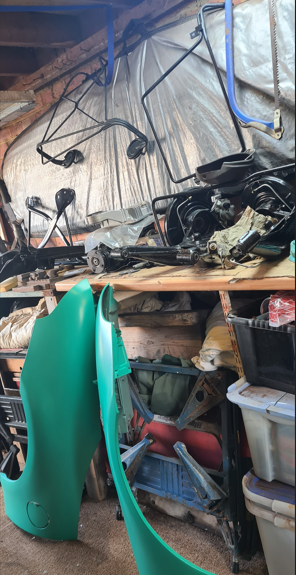

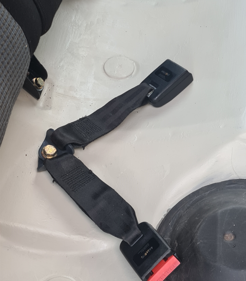

ok so it's been a while !....had to do some work on the Peugeot, fitted a new DPF, repaired a hole in the boot floor and as the seat belt brackets and bolts were rusted...you know what I did didn't you..... yep, clean, prepped and hammerited the brackets, and... zinc plated the bolts ! =))
After that, was a two week break in The Maldives 🌴🌴🍹🍹🥃🥃🥃...... oh so very nice, which also made me a tad lazy... so this weekend it was back on the zed !... today was rebuild day !! and you will see many trials and tribulations and a liberal dose of profanity...

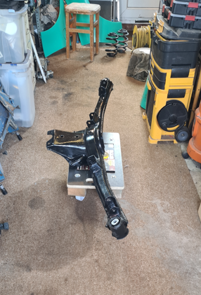

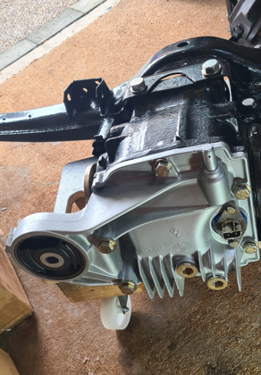

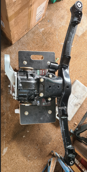

right.... first ....gather all the big bits !
and start bolting them together !.......... and no I haven't added the Diff gasket yet... ( this is me lying on social media... ssssshh)
so far so good....... then..... I'm about to hit my first snag..... those who have done this on a trolley might guess what it is.....no scrolling for the answer and don't copy your friends answer !
ok so here is comes........ adding a Trailing Arm.... you quickly realise.... idiot... the hint centres around the washing up bowl
That's right kids !.... now I can't move it !.... yay !!! or move it under the car ! yaaaay !!!
decided on Trolley 2.0 which employed some handy planks (actually it's pallets that I broke up)
now for round 12........ on with the subframe and Trailing arms.... and ???..... yep the whole thing collapsed including the wheels..... OH how I laughed.
It actually trapped my foot, so after much swearing and pulling... I thought... "it's either my foot or the croc.... one of us has to go".....so I sacrificed my trusty croc....
I sensed another modification..... bracing !.... Trolley 3.0
now we're cooking with gas !!... so flipped it over and away we go...
so for now.... we have a rear subframe !!.....
Next steps, apart from putting on the driveshafts is to tighten and torque everything. I might wait to put the rear discs on after I've put the subframe back on the car....
