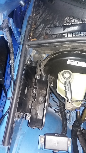

Hi @mrscalex, yes it is an auto, you would think that they might have fitted a temperature sensor so the fan only ran if needed.
I notice in the cct diagram that the M version is fed from the DME but the Z3 is just to ground, maybe the M only turns on when required, but Z3 version runs all the time.
I have not done much work on forums, do you normally refer to each other by @name or just reply in general to everybody. Thanks for doing the digging, its great to know a little more detail.
