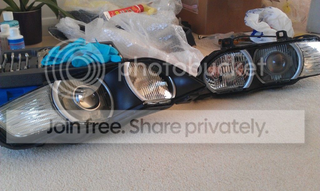

Spent the majority of friday afternoon on the retrofit. Here is where I am now:
I marked up the reflector and cut off the high beam at the middle joint. I then matched up the brackets, mounted up the projectors and fitted in place on the existing ball joints. In between these steps involves a lot of lining up of the projectors and sanding down to keep the high beam in check. I chose to complicate things slightly by retaining the inner high beam halogen lamps. The setup is bi-xenon so its essentially not required but I want to keep the originals for a more OEM finish, this setup seems quite common on newer cars as the bi-xenon flash isn't instantaneous. It would also seem a shame for the inner light to be doing nothing!
