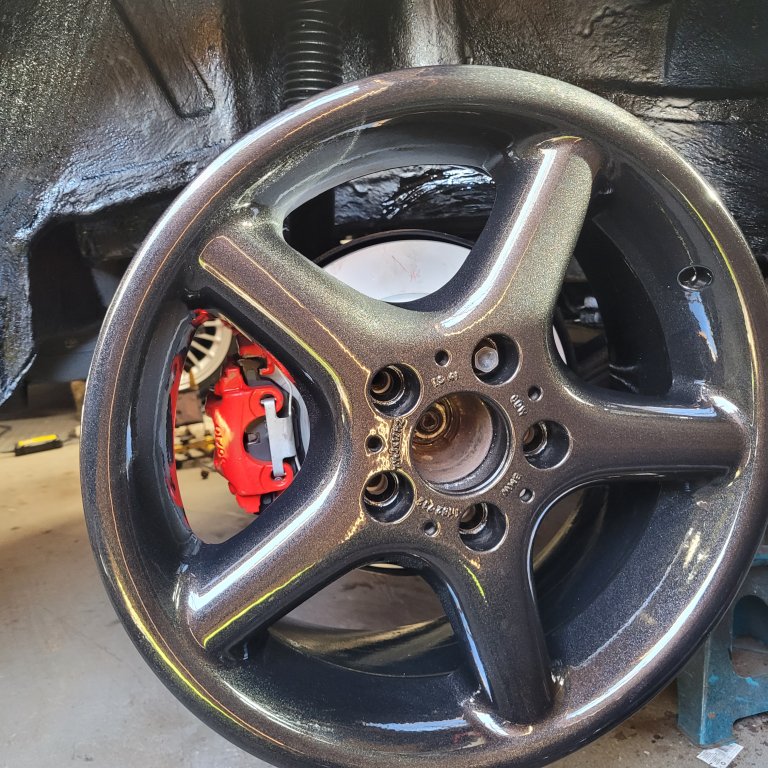

They had a nice dark anthracite in a gloss that I've gone with. Its roll of the dice but my thinking was black might look off against cosmos black as cosmos has got a tinge to it. black wheels might make the car look less black if that makes sense... Its all just a bit of fun any way.

More powdercoated goodness.. I am just waiting on new engine mounts arriving and I'll start building the front end. I am going to instal toyo Tr1s on the wheels, as that's what I run on my e30 and I can't fault them for wet grip. Something that's a must in Scotland. In the mean time a sneaky look at the wheels. Ignore the picky 1/4 panel for now. Top side rebuild will be phase 2

Nice and shiny parts. I did think about doing the sump and bottom end bearings whilst the subframe was out but I think I am going to change the engine even if its just for another m44. My mate has a 75kmile engine in his shed. It'll be phase 2 though after I get it road legal again
More nessecity for me. She's bleeding oil from the sump. Only tidy way of getting there is subframe off but that's not for me me to worry about. I just supply the bits.
Not sure I'd attempt it even with a garage so well done for getting so far with yours.
Any thoughts on wheels?
