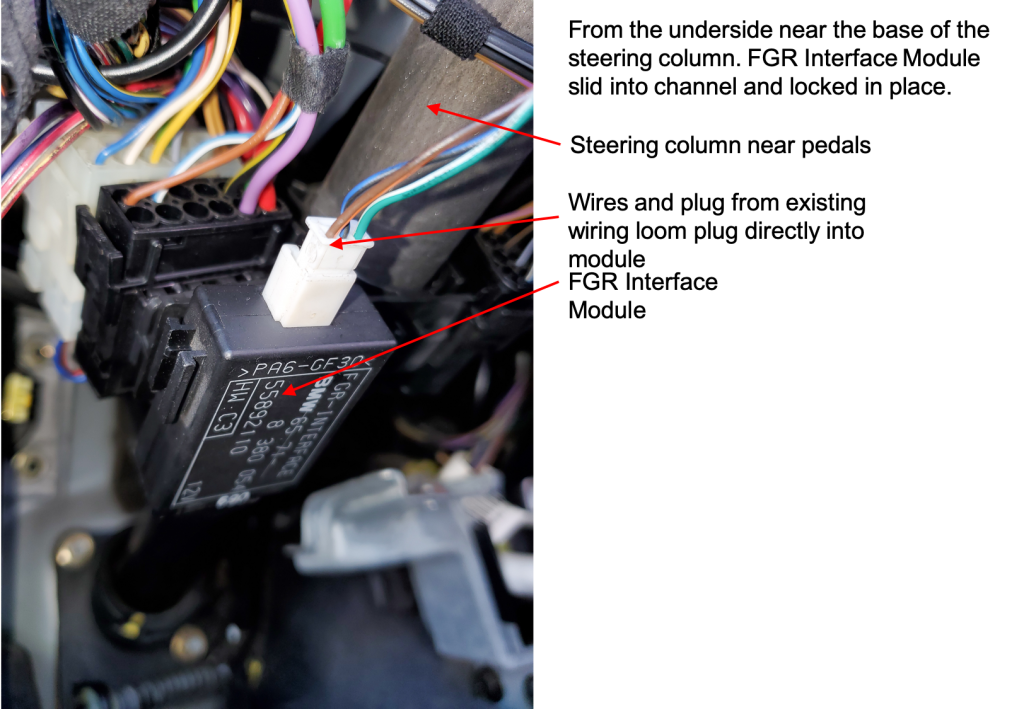

Just to follow up and wrap up this thread, I took a few pictures of the components mentioned in the thread. Keep in mind these are images of a USA car with fly-by-wire cruise control (despite having an accelerator cable, a M52TU characteristic). The car is a 1999 Z3 with 5sp manual. Again, thanks to @Murray Wall for his help!
