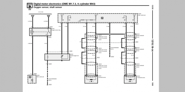

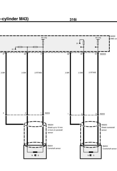

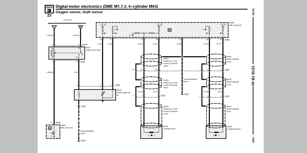

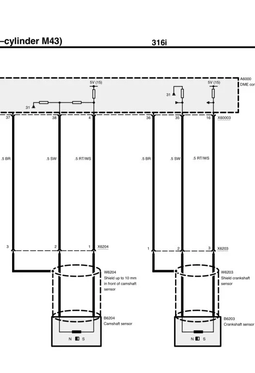

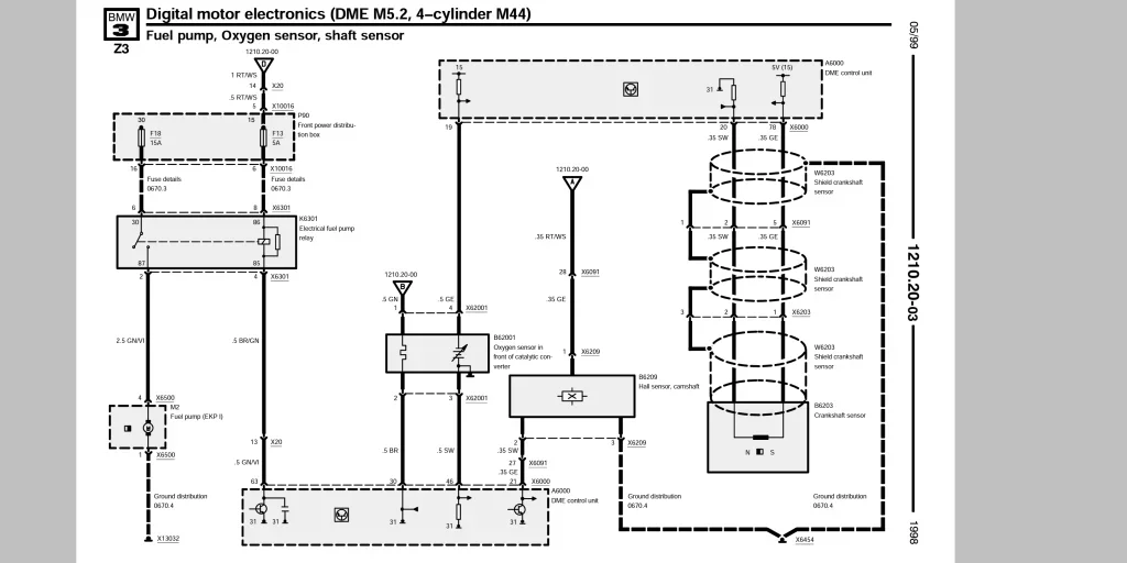

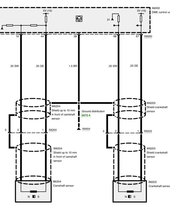

Your so close to it working, I wonder if the wiring to the Camshaft sensor is different, do you have a wiring diagram from both loom types to see if they're the same ?
Daspete
Jan 13, 2019
60
I see what your saying now. I don't know for certain but it might cure your sensor issue. I doubt it would work with the M43 ECU see if the connectors are the same.
To go down the M44 loom route you would need to order yourself an EWS delete ecu (sub £140) this will then allow you fit what ever M44 engine you like if you didnt the EWS system will get confused trying to carry out its security protocol.
I've checked the wiring diagram and it's different for each engine which is a pain .

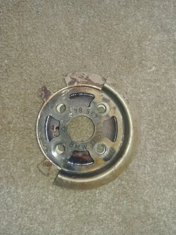

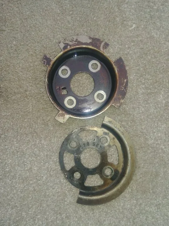

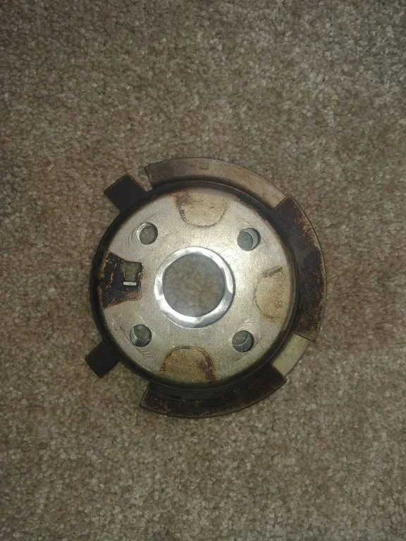

By the looks of the trigger wheels one is batch fire and one is sequential. I'm assuming the dme doesn't like the strange triggering. Modifying the wheel to batch may work but it'll probably sacrifice performance if it does work.

One would assume as I'm using the M44s wheel that it's all ok and will match the crank trigger wheels version of tdc. However I get the feeling the dme isn't expecting the other tabs so throws a wobbler and says it doesn't like the signal.

That's what I'm thinking. Need to cut off the small tabs and weld them in the gaps. Problem being i don't have a mig welder or a high enough skill level. Only got an arc which is inaccurate and will obliterate it.
It's pretty much the only thing i can think of or the map being off.
I tried the M43s wheel with some modifications to make it fit the follower. Which was welding nuts to the back and it just back fired or ran badly.

Got the pick up wheels out and they are wildly different. I think modifications to the wheel won't work and it's potentially the map.
