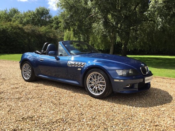

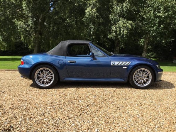

So I just placed a deposit on a 3.0i today. for £5999 2001 and has 111.000miles on the clock, comes with a hard top
Here are some pictures:
