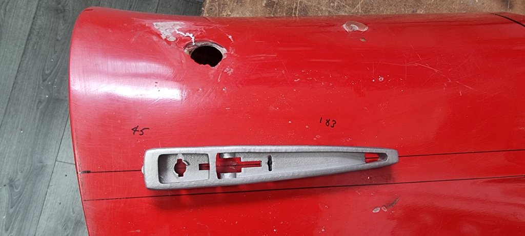

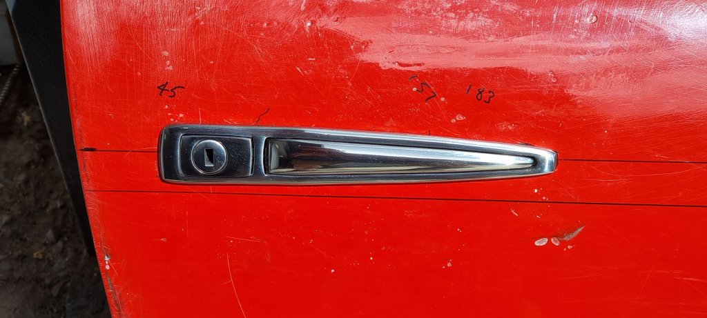

I mounted the handle on the door today. The image below shows where I mounted it. The centre of the handle is around 15mm above the swage line. Having seen where it's internals ended up I think it needs to go another 10-15mm higher up the door than this.
The end of the handle is 45mm from the edge of the door panel. This too is about as close as it is able to go to the edge of the door. Another 5-10mm towards the front of the car would be better.
Inside the 507 handle lever and the cable guide do not match up as well as I would like. The Z3 lever end is exactly where it needs to be so I have to tweak the external handle end of the cable guide. I also discovered that the Z3 lever return strength is not enough to return the lever to the rest position, this is partly due to my aim of ensuring that there is never any load on that lever which, in my understanding, is what leads to deadlocking. I can easily fix that by adding a lever return spring. I verified this by inserting a spring and it did a great job, I just need to make some fixings and choose a more suitable spring.
In my earlier post I mentioned that I wanted to make a few tweaks. They were intended to make installation easier. Having been through the exercise today I think that simplifying the installation is essential. The handle is in a very difficult to access location so making installation easier is a must.
The upshot is that the design of the handle is good. It operates well and there is more than enough leverage to operate the Z3 lever with plentry of slack in the cable. My focus now is on making the installation simpler and adjusting the cable guide to better suit the actual positioning of the handle on the door. Piran and I spoke and I'm hoping to get a set of handles to him by the end of the month...

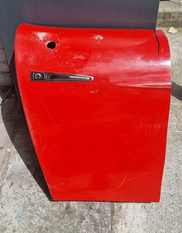

Having bought and installed a pair of these from Russell (argy), albeit different handles but the same idea and mechanisms, I am at a bit of a loss as to why the distance of the handle centre 'pull' to the door edge is so important TBH.
I am presuming the idea is to keep the bit of string (tiny braided wire) as straight as possible through the cast 'guide' to keep wear to a minimum?
If this is the case, it doesn't really matter IMO as the braided cable is going to wear on the inside of the cast guide no matter what, as soon as you tighten and pull the cable. The guides are rough casted and you can't smooth them internally as they are far too small.
I have installed my handles around 30mm further forward than Russell's template, as it looks far better. The only downside I can see is that because the cable now pulls at an angle, it touches the cast guide at the top, but as said above it touches and is going to wear inside the guide anyway.
The cables Russell uses are so thin I do worry how long they are going to last before wearing through TBH.

Is your handle the exact same size as the original I sent you? ie my rubber grommet will still fit. (Assuming there's space for a grommet?)
argy
Mar 9, 2024
18
I believe the original will fit. I will also supply a 3D printed gasket / grommet. I intend to shift it another 5-7mm closer to the edge of the door for improved functionality with the new design. It's becoming real now that I've actually got something on the door...
Duncodin
Sep 8, 2021
159
Pontrhydyrun - in Crow Valley
M44 FrankenZed
Mine's about 35mm from the edge of the door IIR

Also - don't ask me to fit new handles in relation to swage lines. My right hand one isn't where it was
Top and bottom of the door line up but swage line miles out - only on driver side.
Had to cut it off and stick it back on. Don't know if tribute did a design change and I got different doors - or maybe eveeyone else just mounted their driver side higher than the passenger side. 🤷‍♂️

looks a bit tricky :-(...
I think it's a happy coincidence that my design requires the handle to be where it is in the photo. I managed to move some internals to avoid having to move the exterior position of the handle and its position relative to the swage line is pretty much ideal. Moving it up or down would rpobably have required a(nother) different design.
I'll be creating a paper template which will define the handle's position relative to the top of the door panel, hopefully that will be relatively static. I just hope that the swage lines remain static too
A few more design tweaks then it'll be off to production, hopefully within the next week.

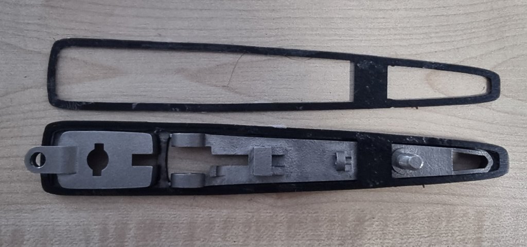

On the subject of door handle gaskets.
I've 3D printed a rubber gasket. 1.2mm thick, it just sits around the edge of the handle. I know that there are others made from moulded rubber which probably form a small cup that the handle sits inside of. I could have a go at doing something similar but 3D printed rubber gaskets can get a bit messy on their top surface which is why I like to keep them underneath. Maybe I could send one to @Duncodin for comparison purposes?
Another consideration is that the gasket looks like it might interfere with the handle's hinge pin. If so I can slim the gasket a bit or maybe trim a small section around where the head of the hinge protrudes.
I think it might be useful to put a couple of uprisers into areas where there aren't any moving parts, just to keep everything tucked under the rim of the handle. I'm thinking at either end of the handle and at the point between the hinge and the push button well.
I'd be interesting to see the shape of the original... Any photo's available?
Ian, let me know if you'd like to review the gasket, I can send you a handle base too. I've ordered some more of everything in what I hope to be the final iteration so it's back to the waiting game...
