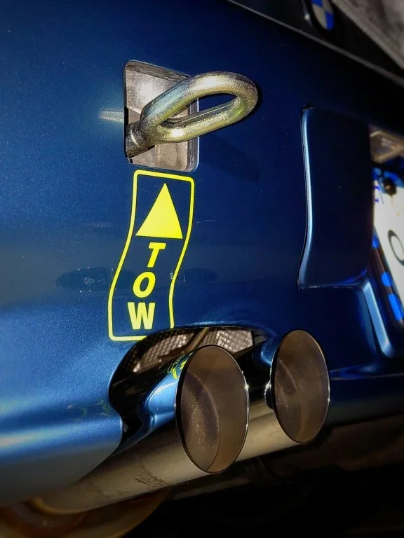

I think the Z3 I bought a few months ago has the exact same cat-back. I like the note. Wondering though if you've noticed a rattle coming from the exhaust swinging too freely left and right when going over bumps and causing the tips to smack into the bumper cover? Mine is, and I'm trying to figure out if that's to be expected or how to fix it (literally and figuratively) so that it doesn't do that.Supersprint Performance Race Muffler installed. It took about three hours start to finish. All the nuts came right off since the car has zero rust. It's super easy to change out...two bolts at the cat, three hangers. Just a lot of up and down and moving/sliding myself around to get everything in line, etc.
Love the sound. Burble---ee but not too loud, no back-firing noises....yay! Maybe a touch louder than I expected, but it's so hard to tell on Youtube. One caveat they don't tell you...ya need the connecting pipe and a Walker 31370 Exhaust Pipe Flange Gasket!
