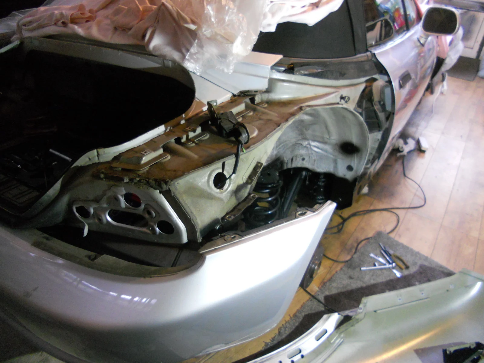

found rust.
  • Media owner andz zed3
Check out underneath panel sealant around the tail light aperture, I'm glad I peeled it back and stripped it off as it was not good, now back to new metal and acid primed and high build stone guard coated.
