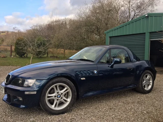

Hi everyone,
I have now completed the general overhaul of our 2000 year 6 cylinder 2.0 ,only48000 miles from new Z3 ! You may recall the pictures of the mice living in the inner cills when I started the strip down. Well I attach (hopefully !) the completed car, it looks stunning with a new coat of the original metallic Aegean Blue.
