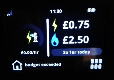

I'm trying to understand these , I assume most energy is consumed by heating ?..I have solar and will be getting a battery when they become available (date has slipped from June 2022 to Jan 2023).

No, the heating is by gas.I'm trying to understand these , I assume most energy is consumed by heating ?..
