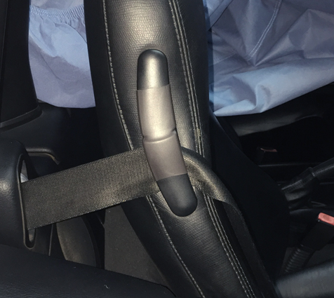

@Jasn What state are yours in now? I had mine break and I was unable to get any of the "repairs" in the clips etc so I did this......
Heat shrink from Jaycar Electronics..... Not as good as replacing the guide but much better than having them break completely.
Unless you look closely, no one notices it.
Note: the flash has made the colour look different to what it is in sunlight.

@Jasn What state are yours in now? I had mine break and I was unable to get any of the "repairs" in the clips etc so I did this......View attachment 111547
Unfortunately my driver's side one is missing completely and the passenger side has the bottom part missing (apart from the bit under the leather). I'd be happy with what you've done there, but it won't work for mine. If I manage to get them replaced I will do something like that to reduce the chances they will break again.
I was lucky in that the drivers side had broken but not come away from the seat.... the passenger side was OK.
I put this on both... and for that matter on my Fathers car as well to sort his.
Now very functional and do not look too bad.
