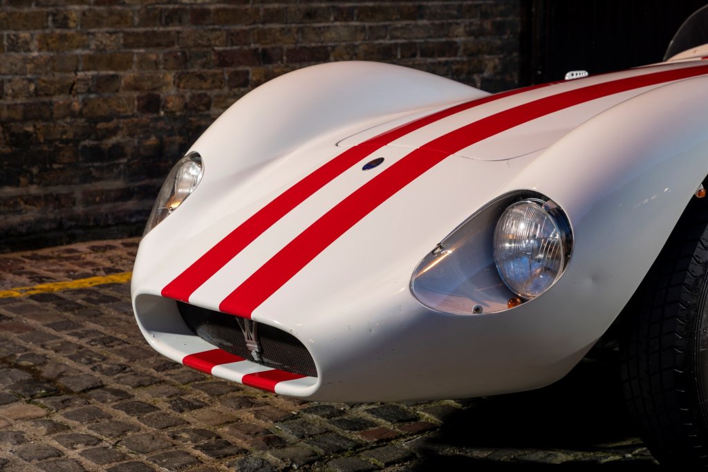

I have side repeaters and high level brake lights on both of my rebodies because the original Z3 had them.
Nice 'dots' on this classic:
