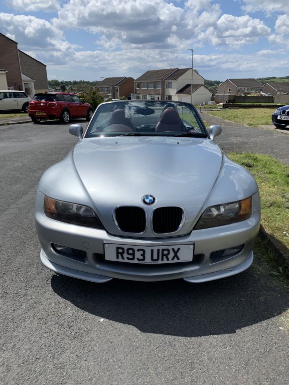

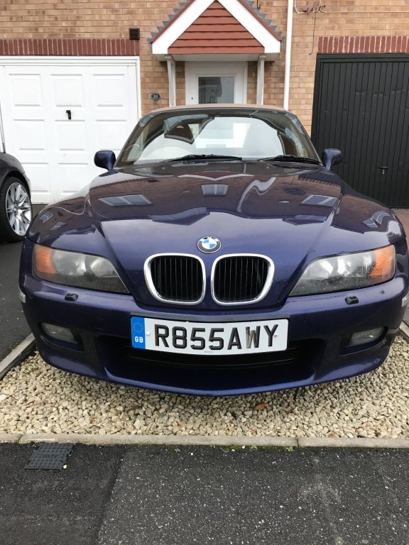

3 OEM bumpers to my knowledge.
4 cylinder engines - no side lights as they were in the headlight unit, and a thicker lower lip in the middle of the bumper
(Ignore the AC Schnitzer front corner parts as these are an extra)
6 cylinder - have sidelights integrated into the corners and a thinner centre bottom lip.

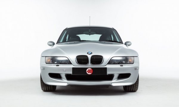

Z3M - There own bumper
