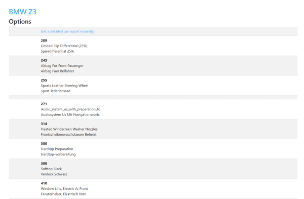

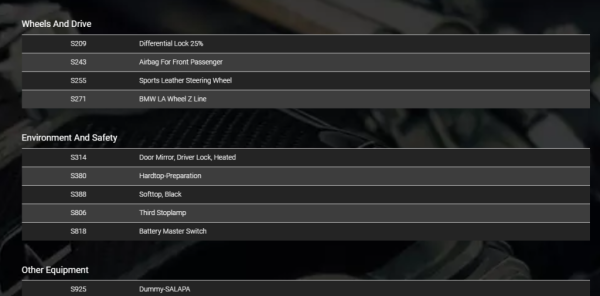

It's been around 9 days that I m reading non stop information, and honestly, the more I read the more confused I become. I got two weeks ago my Z3 1.9 1997 with 98.000km. From mdecoder and bimmer with my VIN, I saw in both websites that I have the option S209(if these sites are trustworthy). From my understanding all z3 1.9 until 1999 came with an open differential, but if you have the option S209 its a Torsen.

As I hinted in my previous post on your previous thread, you need to be sure its a Torsen as I don't think they were fitted before 1999.
"The BMW tech training materials say that the Torsens came out with model year '99, at the same time as the dual-vanos M52tu motor. Prior to that they (officially) would have had clutch-pack differentials."

I've read the same about the pre 1999, but the S209 was supposed to be an option to add the Torsen in the standard versions.
