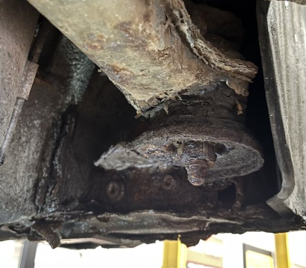

I purchased a 1998 BMW Z3 - 67000 miles - all paperwork, original books etc etc, at auction this week as my first Z3.
Took it for its MOT and it failed on one item, corrosion near the jacking point.
The garage said the repair could escalate very quickly and it may not be worth doing.
My question is what is a car like this worth as not sure what to do right now, I love the car already having driven it from the auction house to the garage.
Any advice welcome right now!

Depends on what you think is how much is worth doing. If the rest of the car is clean and the low miles is bonus fixing would give you a good one. Usually these things dont make financial sense if you just look at it from the bean counting approach. Most of the rusty bits in your photo are bolt on and the metal at the jacking points can be cut out and welded, replacement sills are hard to find. You'd be better finding a mig welder car repair place and get a quote for the work and see what you're working with. The outer sill covers are really easy to remove. It would be worth doing this and checking what else lurks behind. An MOT failure with welding required will hurt the sale price... but the low miles will help. I've bought a couple now very cheap but they've not been clean with low miles.

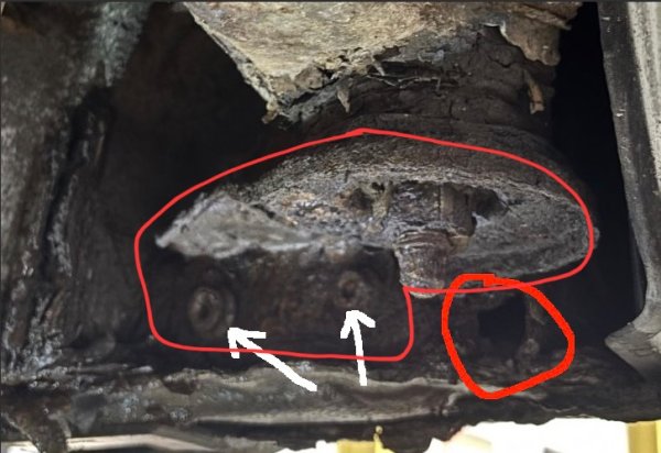

The MOT fail report mentions a (ie one?) hole within 30cm of this cross beam. So I assume this is the one you failed on (in red?) Yep. That's certainly a failure.
You won't need the sills off to fix that - but you did mention jacking points so maybe there's more holes? But, in theory at least, if you get that one hole fixed and go for a retest with the same tester then he might just look at that hole and not look elsewhere.
Welding up that hole isn't likely to be expensive. But it needs to be chopped out proper and not just patched over the rust. Problem is those two screws (highlighted in white). Could be difficult to get out. That plate (called the "push rod") would need to be removed to clean up the hole proper and then hope that the steel around those screws (ie what the screws screw into) is solid.
But if that's all there is to do - as mentioned earlier not many advisories so rest of car looks OK - I'd go for it.
I can't see what the cross member bush is like, too much muck, but it didn't fail on that so don't go there (yet).

Looking at the photo, I would tend to agree with the garage. You really need to check the rest of the underbody bits. As has been said above, the issue you have is the sill and the push rod plate that supports the rear beam. The beam itself looks pretty rusty and I would be worried about similar rust on the trailing arms. Repair costs could easily exceed what you paid for the car.
I suggest getting some more photos under ear the car and getting some advice from our resident Zshed guys.

You've got to wonder how it past its previous MOT as that doesn't look like a year of corrosion, unless its been sat for a few years without a MOT
It's had regular MOTs. Passed last year 3000 miles ago..
That hole looks poked through. Was probably covered in the OEM stonechip/underbody coating so wasn't really visible. Mot tester did a proper job finding it.
