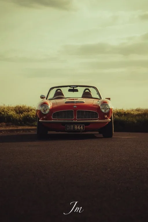

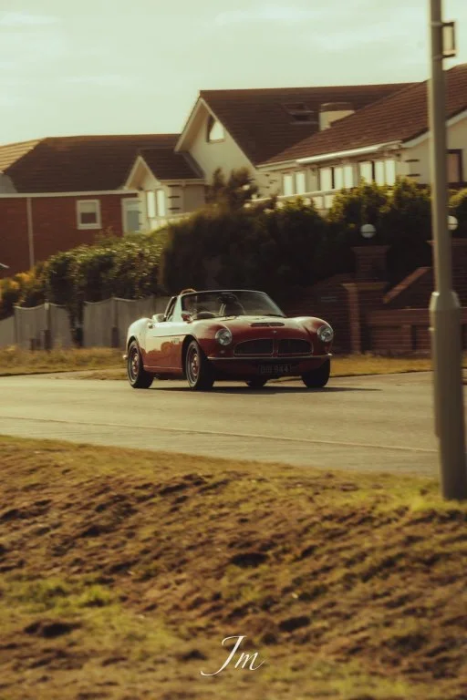

Recent photo shoot

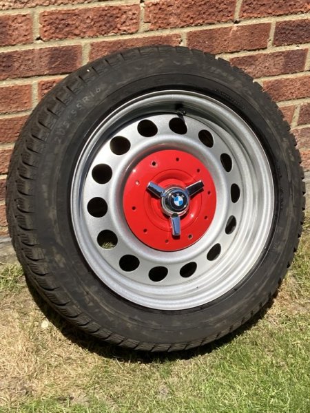

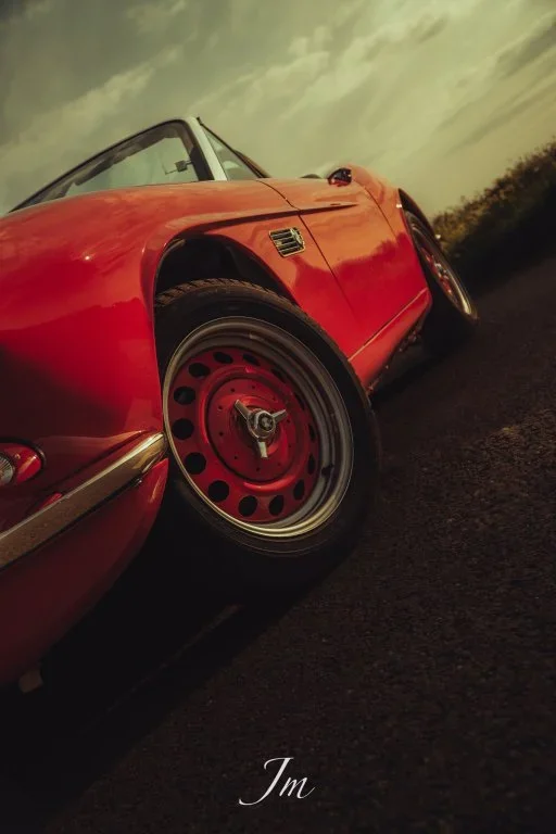

Wheels I want to replicate the Rudge knock offs.
I bought bmw winter steels and had them powder coated.
centre caps are Vw transporter sprayed red with plastic spinners off Amazon. These spinners are bolted on from the rear.
fitying the caps to the wheels isn’t straight forward as Vw use special bolts with oversized heads, and the bolt diameter is 2mm larger than bmw. At present I’m having the bolts turned down and new threads cut so I can use the Vw bolts. Fingers crossed this works so the caps fit. I will update when the bolts arrive
I'm interested in doing the same. Did the work on the VW bolts affect the material? I mean the hardness of the metal? Need heat treatment? Or?
No issues I’m aware of. They have held up ok so far 👌

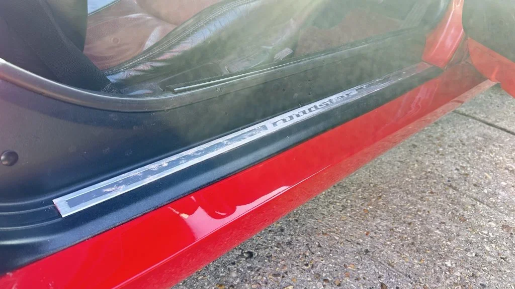

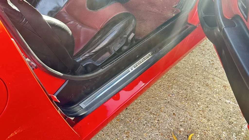

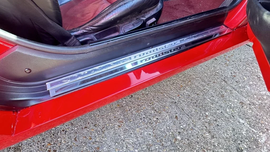

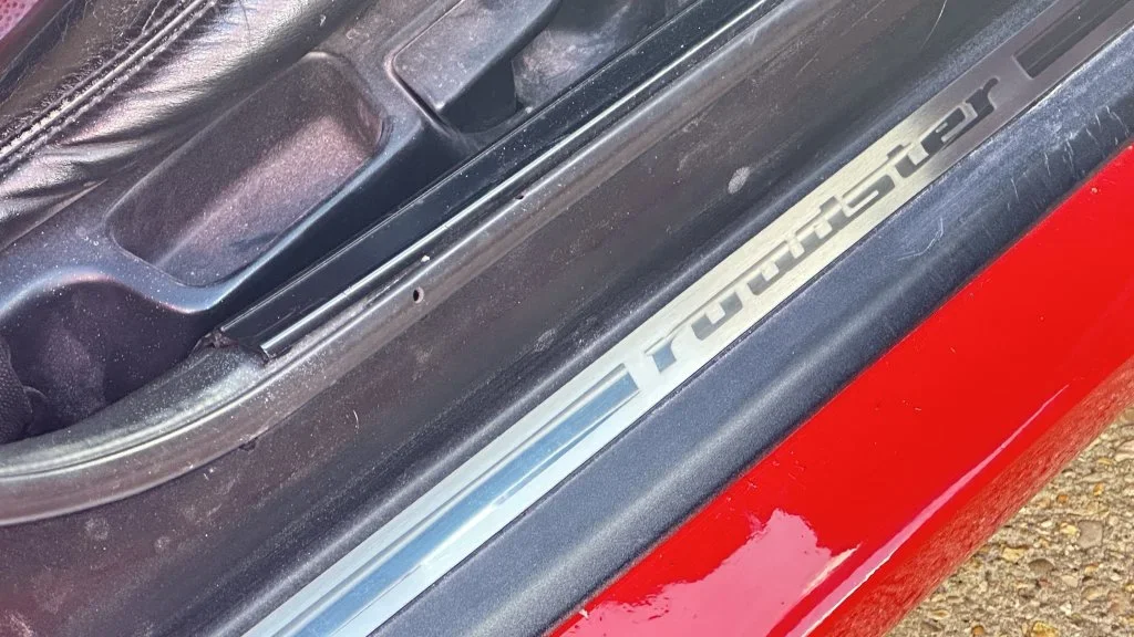

I fitted the new ‘Roadster’ aluminium sill strips inside the doors today. The old ones were corroded and looked tired so I bought the new ones from a place in Germany.
They have double sided tape on the back and I added some Tiger Seal for extra stickiness.
Pictures aren’t great due to reflections but the result is perfect
Please let us know where you bought the inner door roadster strips from*
*forms an orderly queue 🤣
I bought them from Tuneon and I’m sure the price has dropped from when I got mine,
They also seem to be on Etsy
